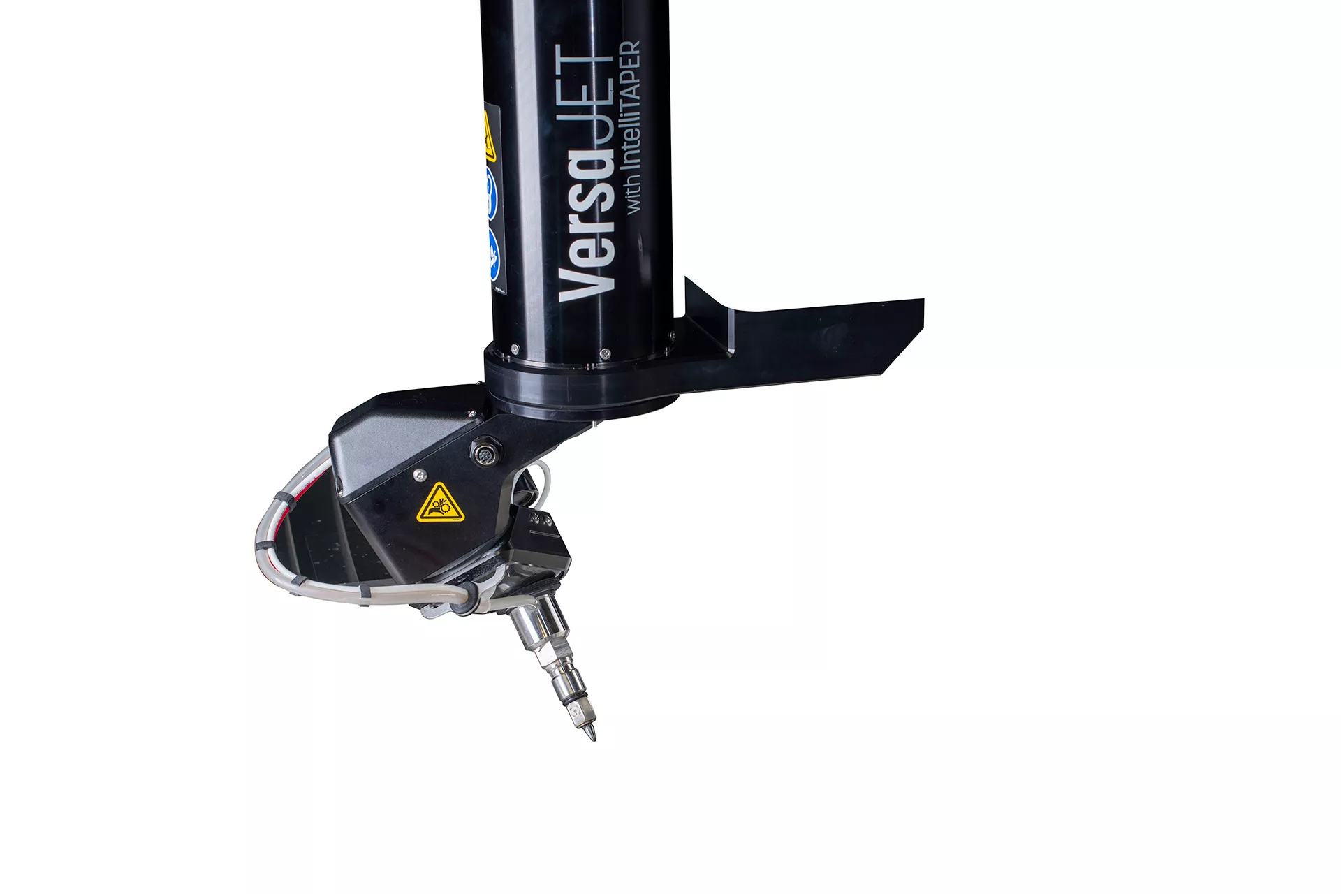

VersaJET
The VersaJET is a completely software-controlled 5 Axis cutting head that greatly expand the versatility of your abrasive waterjet. VersaJET has a cutting range of 0 to 60 degrees for cutting beveled edges, angled sides, countersinks, and complex 3D shapes. The cutting head virtually eliminates taper on finished parts with automatic taper compensation. With its inherent high level of positioning accuracy, the VersaJET can cut parts that don’t require secondary finishing, significantly reducing part production time.
Available on these machines:
OptiMAX 60X, OptiMAX 80X
Contact OMAX Sales
VersaJET by OMAX
Features
  • Completely controlled with OMAX IntelliMAX Software
  • Supplied with a MAXJET 5i Nozzle, which includes an OMAX High Angle Fusible Mixing Tube
  • Fixed focal point design, where the XYZ axes do not need to move as the head tilts

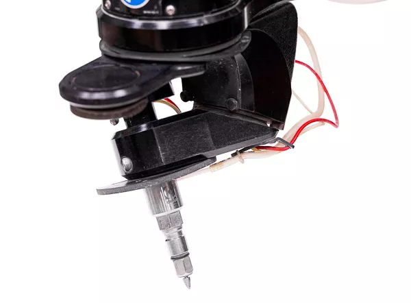

Tilt-a-jet for OMAX waterjets
Tilt-A-Jet
The Tilt-A-Jet represents OMAX innovation in the continuing search for more accurate abrasive waterjet machining. Tilt-A-Jet can position the nozzle at an angle calculated by the software to exactly offset the taper from the abrasivejet. Taper doesn't disappear--it just gets moved to the scrap part of the material, leaving your part with exactly square edges.
OMAX 2626, OMAX 2652, OMAX 5555, OMAX 55100, OMAX 120X, OMAX 160X, OptiMAX 60X, OptiMAX 80X
Download spec sheet
Contact OMAX Sales
Features
  • Automatic re-squaring feature ensures nozzle is square to the table
  • Faster cutting of high precision taper free parts with no need to slow down to eliminate taper
  • Servo-controlled programmable precision Z-axis with 6” of travel
  • Faster cutting due to “tilt forward” capability
  • Programmable manual tilt up to ±9° for the maximum tilt angle

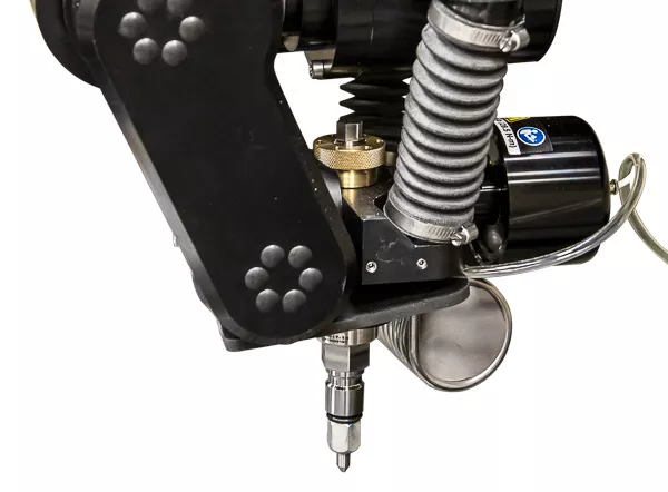

A-Jet
The A-Jet is a completely software-controlled multi-axis cutting head that greatly expands the versatility of the OMAX JetMachining Center. With a cutting range from 0° to 60°, the A-Jet can easily cut beveled edges, angled sides, countersinks as well as complex 3D shapes. With its inherent high level of positioning accuracy, the A-Jet can cut parts that require no secondary finishing, significantly reducing part production time.
Download spec sheet
Contact OMAX Sales
A-Jet for OMAX waterjet
Features
  • Fully automatic taper compensation to minimize taper on finished parts
  • Three modes of taper compensation
  • Designed for high flow/high power abrasive waterjet applications with multiple pumps by using large diameter tubing with minimal pressure loss
  • Features a fixed focal point design, where the XYZ axes do not need to move as the head tilts
