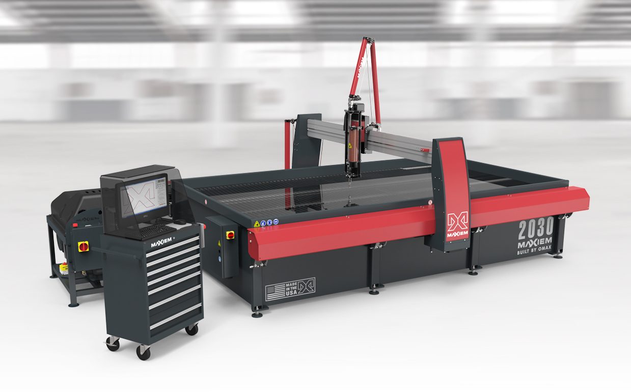

Scale Up Without Slowing Down. Engineered for growing shops, the 2030X handles larger formats without compromising cut quality.
- Cutting envelope of 10' 0" x 6' 7" (3.04 m x 2.00 m)
- ±0.003" (±0.076 mm) linear position accuracy
- Powered by OMAX's own IntelliMAX Premium Software
- Powerful all-in-one controller computer with large 23" screen
- Standard IntelliTRAX traction drive inside the X-Y Axis beams fully enclosed inside coated steel covers
- Standard programmable Motorized Z-Axis with a precision OMAX MAXJET 5i Nozzle boosts productivity and process efficiency
- IntelliVISOR Mobile puts machine monitoring in your hand allowing you to review status, get notification and remotely pause operations. Available on IOS and Android.
- Designed and manufactured at the OMAX factory in Kent, Washington, USA
- Does not create heat-affected zones or mechanical stresses
- Machines a wide range of materials and thicknesses, from metals and composites to glass and plastics
- No tool changes & minimal fixturing dramatically reduce setup
