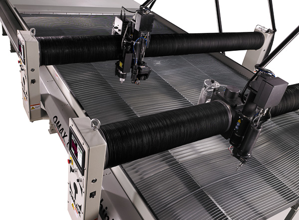

DualBridge System
The DualBRIDGE System is a configuration option that allows the addition of a second Y-bridge to boost efficiency and flexibility. OMAX's DualBRIDGE System, two Y-bridges work independently from each other, significantly increasing machine capacity. The bridges can be programmed to produce separate components or can work in tandem to cut one large part.
Available on these machines:
OMAX 120X, OMAX 160X, OptiMAX 80X
Contact Sales
Features
- DualBRIDGE System makes use of OMAX IntelliMAX Premium software
- All existing OMAX accessories are fully compatible with the addition of a second Y-bridge
- Optional touch screen monitors on the Y-bridges for easier access to computer controls
- The DualBRIDGE System boosts utilization rates as your cutting can be performed while materials are loaded and unloaded from the machine
- To achieve the fastest cutting speed in the industry, you can configure the system with multiple cutting heads and pumps on one machine
