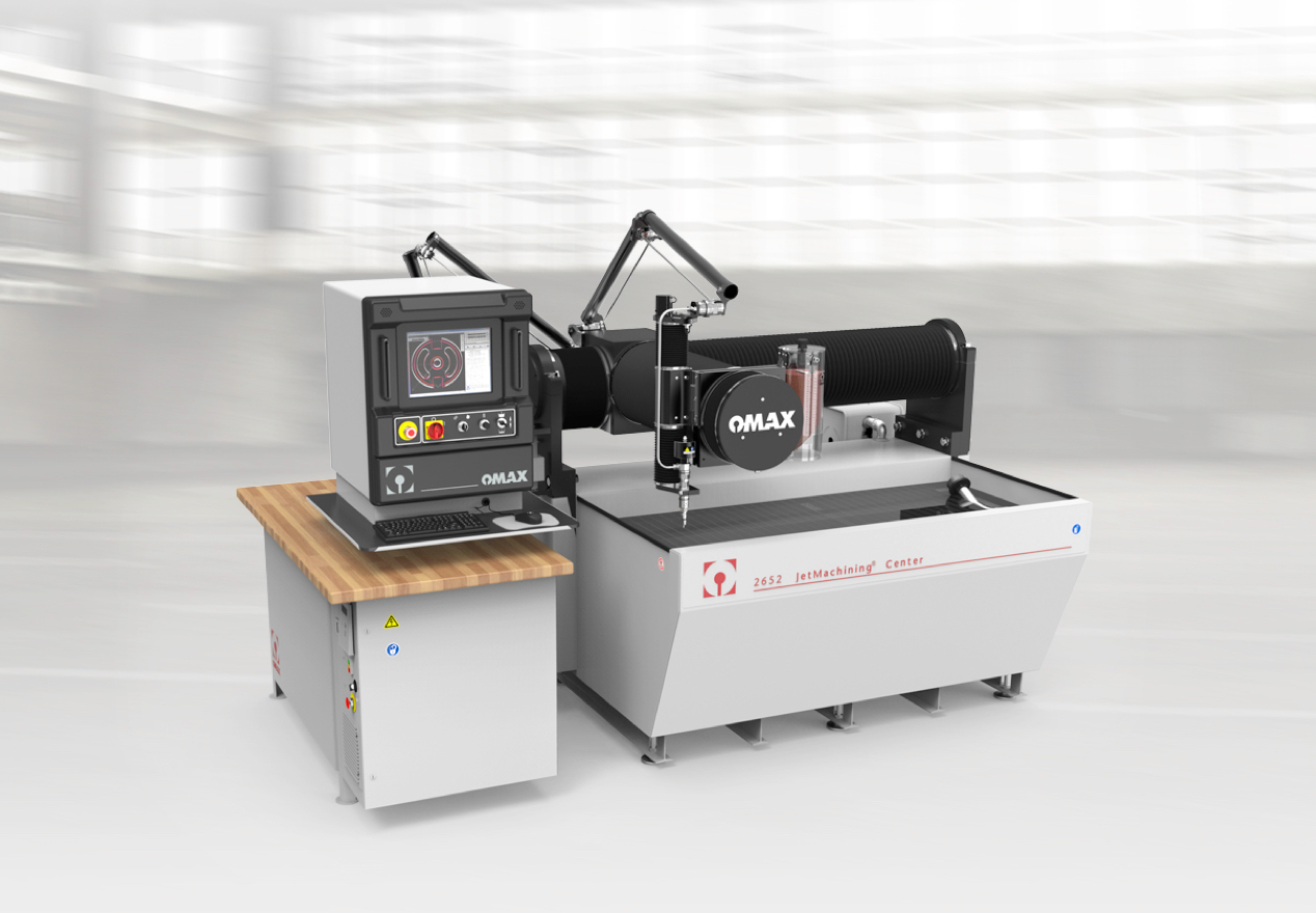

The OMAX 2652 offers a small footprint for space-challenged shops, allowing plenty of cutting envelope.
- Cutting envelope of 4' 4" x 2' 2" (1.32 m x 0.66 m)
- ±0.001" (±0.025 mm) linear position accuracy
- Backed by OMAX’s exclusive IntelliMAX Premium Software
- Robust and accurate design for tight tolerance cutting and reliable operation
- Pre-loaded linear bearings and precision ball screws
- Shipped as a completely pre-assembled and factory-tested system
- Standard programmable Motorized Z-Axis with a precision OMAX MAXJET 5i Nozzle boosts productivity and process efficiency
- Standard scissor-style hard plumbing adds another level of safety by using contained high-pressure components, as well as contributes to a smaller footprint, lower maintenance, and higher reliability
- Standard Rapid Water Level Control for cleaner, safer, and quieter submerged cutting completes most work below 80 dBA
- Designed and manufactured at the OMAX factory in Kent, Washington, USA
- Does not create heat-affected zones or mechanical stresses
- Machines a wide range of materials and thicknesses, from metals and composites to glass and plastics
- No tool changes & minimal fixturing dramatically reduce setup
- Unlimited free training for the life of your machine
- Unlimited software upgrades for the life of the machine
- 2-year / 4000-hour limited warranty
- 3 days of onsite training upon installation
