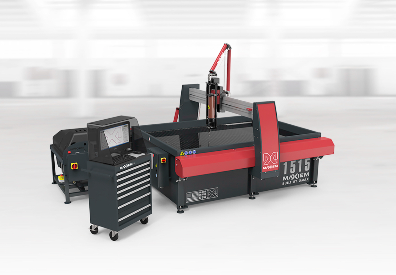

With an ample cutting area that easily fits material stock, the MAXIEM 1515 is an excellent fit for fabrication and job shops.
- Cutting envelope of 5' 2" x 5' 2" (1. 57 m x 1.57 m)
- ±0.003" (±0.076 mm) linear position accuracy
- Backed by our exclusive IntelliMAX Standard Software
- Powerful all-in-one controller computer with large 23" screen
- Standard IntelliTRAX traction drive inside the X-Y Axis beams fully enclosed inside coated steel covers
- Standard programmable Motorized Z-Axis with a precision OMAX MAXJET 5i Nozzle boosts productivity and process efficiency
- Designed and manufactured at the OMAX factory in Kent, Washington, USA
- Does not create heat-affected zones or mechanical stresses
- Machines a wide range of materials and thicknesses, from metals and composites to glass and plastics
- No tool changes & minimal fixturing dramatically reduce setup
- 1 year of free training
- 1 year of free software upgrades
- 1-year / 2000-hour limited warranty
- 1 day of onsite training upon installation
DIMENSIONS & SPECS
Footprint (with pump & controller) | 13' 3" x 12' 5" (4.04 m x 3.78 m) |
Height (with whip plumbing) | 10' 6" (3.20 m) |
Operating Weight | 14,114 lb (6402 kg) |
Weight (tank empty) | 6,000 lb (2722 kg) |
X-Y Cutting Travel* | 5' 2" x 5' 2" (1.57 m x 1.57 m) |
Z-Axis Travel (with Motorized Z Axis)* | 12" (304 mm) |
Table Size | 7' 4" x 5' 8" (2.24 m x 1.73 m) |
Material Supports Slats | 4" x 14Ga Galvanized Steel (102 mm x 2 mm) |
Maximum Supported Material Load | 300 lbs/sq ft (1,465 kg/sq meter) |
Electrical Requirements | 3-Phase, 380-480 VAC ±10%, 50-60 Hz |
Noise Level | Below 80 dBA at one meter for submerged cutting |
Speed | 500 in/min (12.7 m/min) |
Linear Positional Accuracy* | ±0.003" (±0.076 mm) |
Repeatability* | ±0.001" (±0.025 mm) |
